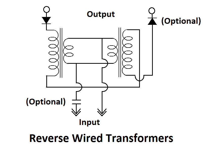

    I've got a simple millivolt hv supply.  I took two identical transformers from some wall plug adaptors and reverse wired them, with series outputs.  The 12 Volt transformers are now putting out 2400V, at approximately one milliamp.  I'm using a string of four 1n4006 diodes which are each rated at 800V and one Amp.  With a 7MFd current limiting cap on the input, the diodes just barely get warm.  Without the cap, everything over heats, because the small transformers' secondaries aren't designed to be hooked to the mains, as primary windings.
    This supply produces a small but respectable amount of little bubbles, which do pop under a flame.  (Using well water).  Something I've noticed is that with my plate cells, separated by thin strips of plastic, the bubbles are primarily produced where the plastic touches the metal.
     Now I'll reverse wire a couple of MOTs and run them with a genset, rather than a small inverter.  I'll current limit them with one or two motor running capacitors.
  2. tektrical
    With this assembly, a single transformer is adequate for running a cell.  So I can run two cells, with the optional diode and using the secondary cross over wire as a center tap.
    When I designed this configuration I was hoping for a bipolar output, and I've verified that is what it provides.  It's ike a single transformer with a center tap, when such is not available otherwise.  (As with a MOT).  With some added components, I can test this for powering a shape resonance circuit.
    Using this with one cell, without the optional diode, gives opposing positive and negative pulses to the electrodes, with an additional unbalanced positive pulse going to one electrode.  Or perhaps I should reverse this polarity since almost all of the bubbles are coming off the negative electrode, whether it's on the inside or the outside.
  3. Steve
    So the two output leads provide a pulse at the same time?
    Should they cancel eachother out?
  4. tektrical
    The pulses have opposite polarity.  So this is actually doubling the intensity of the potential.  I tried wiring the secondaries straight across, and that's when the pulses cancelled out.  But it still works with a single transformer pumping hv electrons into the water.  Apparently, the second electrode builds a positive charge which pulls against the negative pulses, even when the pulses are out of phase.
    This must be what Stan meant about switching off the covalent bonds.  With electrons all around, the Oxygen doesn't have to hang on to the Hydrogen to get it's extra electrons.
    This definitely isn't normal water splitting since the bubbles only come off one electrode.

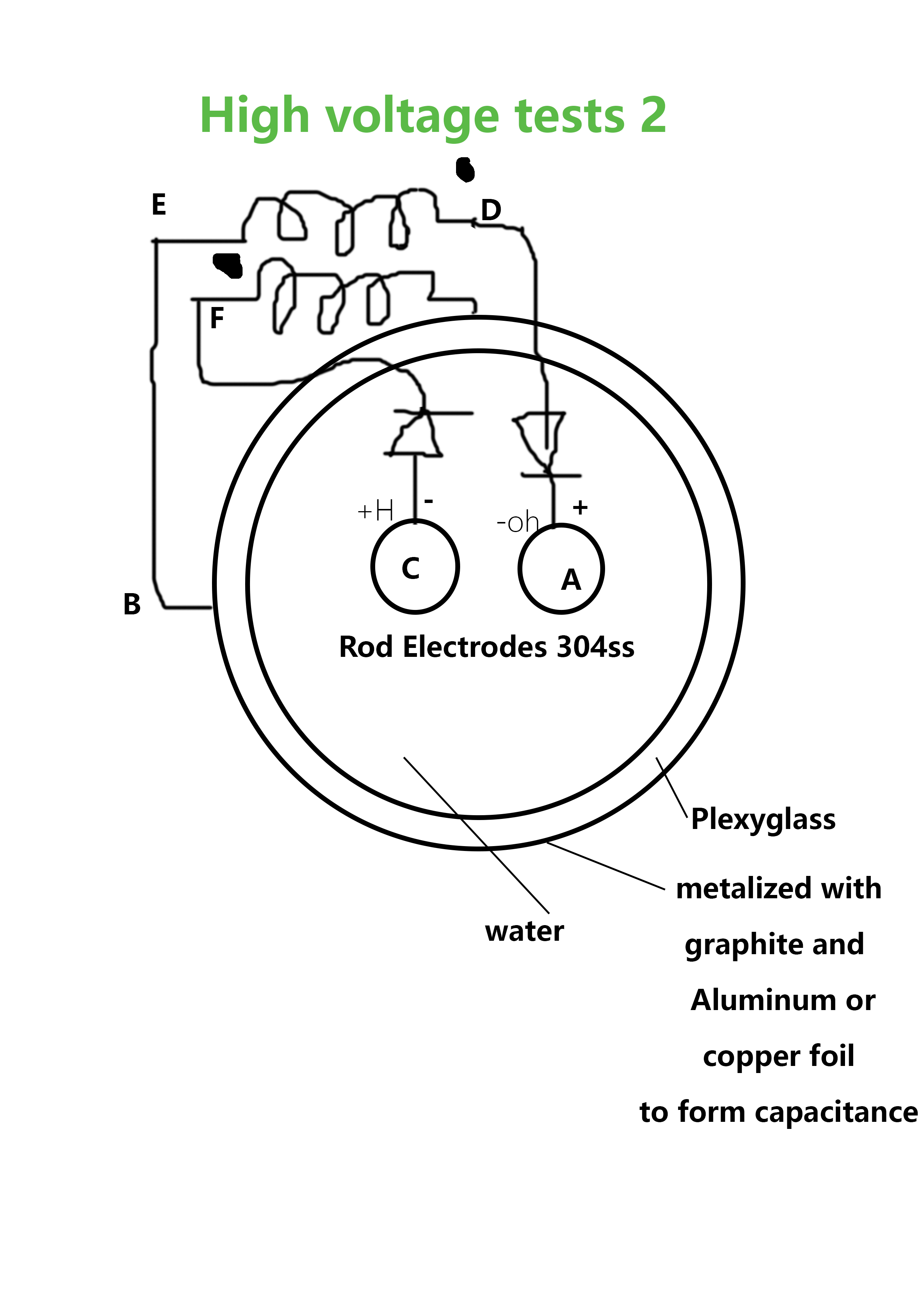

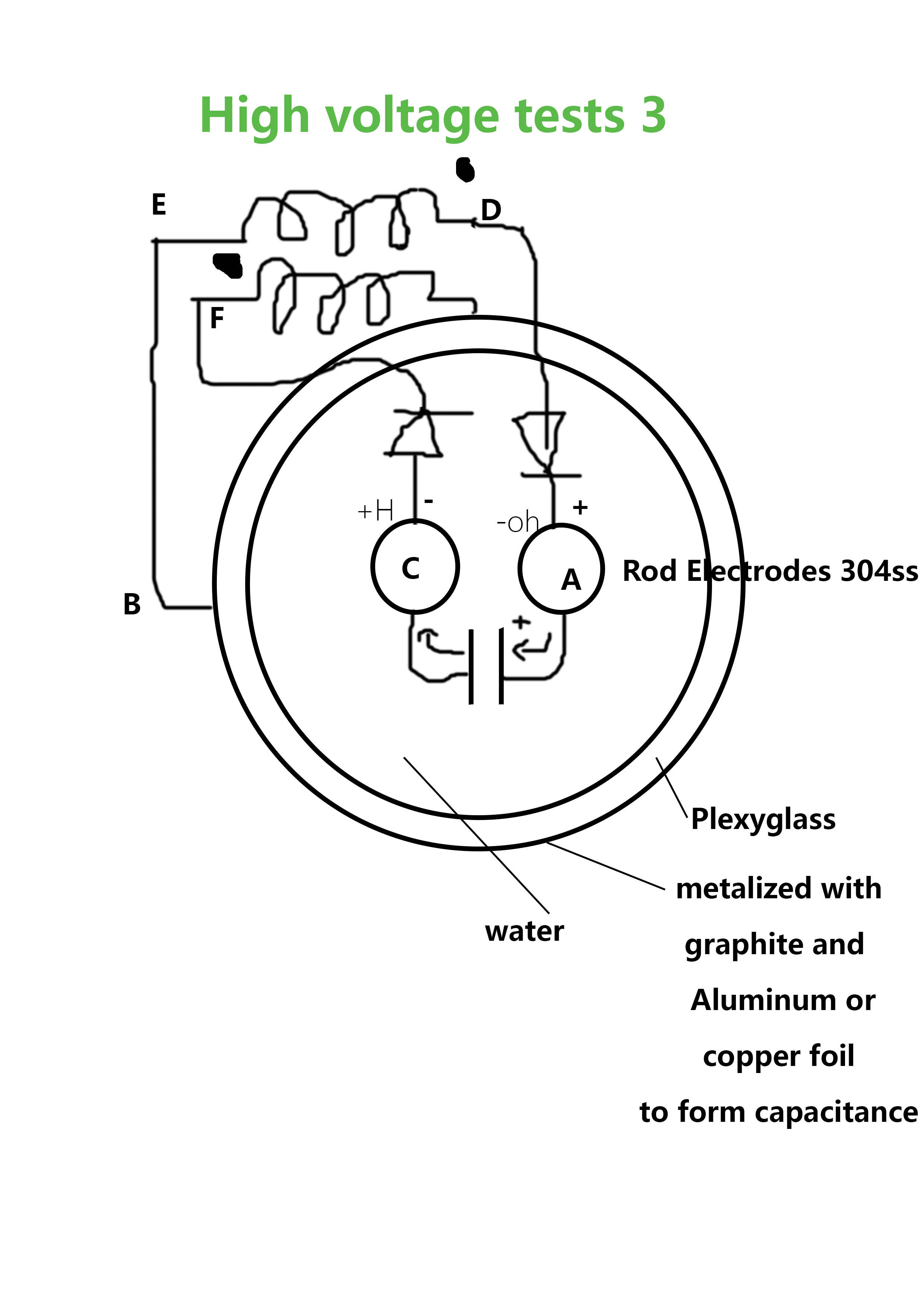

    Im going to show an idea and remember some
    van de graf teached us how to charge from inside to get a bucket with high voltage from a low voltage
    Lord kelving showed that a slight charge unbalance can lead to high voltage with his water dropper
    And some how the back to the future film came up with a delorean car with flux capacitor that supposed to do something
    i was in a discussion about the plane earth hahah with a friend and they were arguing that if we cannot see the boat at horizont is because of difraction of light or something... but i explained to them that if we are in the same medium it will not have this difraction it only happens when you look from diferent medium like when you see a fork inside water is going to look strange if you look outside from water but will not look strange if you look from inside...
    likewise i will start from the end... i was doing two drawings to explain my idea to you and came up with another memory :
    CHARGING BY INDUCTION (FLUX CAPACITOR) HAHA
    basically when you charge an electroscope permanently by induction you are using the electric fields to set up a displacement of charges that favors the neutralization
    well the same is for a capacitor
    if you apply high voltage to one side initially the other leg will have pretty much the same voltage applied to it and will start to ionize air and likely to charge the capacitor slowly a bit
    well
    let me show you the drawings and lets talk about that
    lets stick to the first drawing
    you see that you have a resonant tank and it can be driven in series or in parallel.. it will bring to high voltage easily at the resonant frequency...
    at resonant frequency in series the Z goes to zero so it will have only the resistance of the coil and "water" as a damping factor so you can calculate the voltage Vt needed for a certain current I you desire. I=V/R
    knowing the voltage Vt the frequency F and the current I and XL you know the resonant voltage I*XL ... the circulating current is the same as is in series
    well now comes the interesting part how could we use one electrode to induce a current on the other electrode?
    I was imagining the capacitance between each and ground and came up with the following idea
    if we connect a capacitor between the electrodes in this configuration we could have some different stuff happening since this capacitance will stay charged will not participate much to the resonance after charged and likewise will give some connection between the electrodes... perhaps a very high capacitance would be nice to keep the charge on each electrode...
    when a certain current is achieved the water must split at very high rate... and will be high voltage generated...
    the diodes can be really a bunch of up to 50x 4007 diodes in parallel... i like to use the UF4007 version  the more diodes less loss will be on them...
    also the coils should be thick to get a decent resonance.. or you can just apply more voltage... likewise more power will be dissipated on them
    the water will heat up and container too... this are the losses...
    http://www.ionizationx.com/index.php?action=dlattach;topic=4139.0;attach=16160;image
    the nice thing of the test 2 circuit is that the resonance happens with the fields jumping from one coil to the other... and more it jumps when is at maximum value. perhaps it can be an advantage to think this way
    test1hv.png test2hv.png hvtest3.png http://www.ionizationx.com/index.php?action=dlattach;topic=4139.0;attach=16160;image
